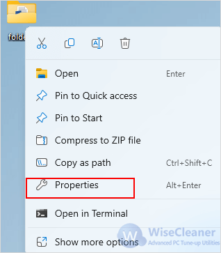

Step 1: Open the Properties window of the folders
Locate the first folder, right-click on it, and select Properties. Keep the Properties window open and perform the same steps for the second folder.
