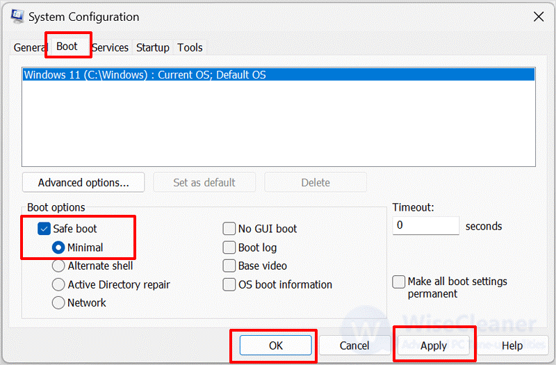

Method5. Enable Windows 11 Safe Mode from System Configuration
In addition to using the above method, you can also select System Configuration to enable Safe Mode.
Step1. Open the System Configuration
Click on Windows Start and type System Configuration in the search box. Find the matched item and open it.
Step2. Enable Windows 11 Safe Mode
Once you open the System Configuration, click the Boot tab. Under the “Boot options” section, check the Safe boot option. Choose the Minimal option to start Windows 11 in Safe Mode. Finally, click on the Apply button and select OK to close the window.
Restart your computer for the changes to take effect.
