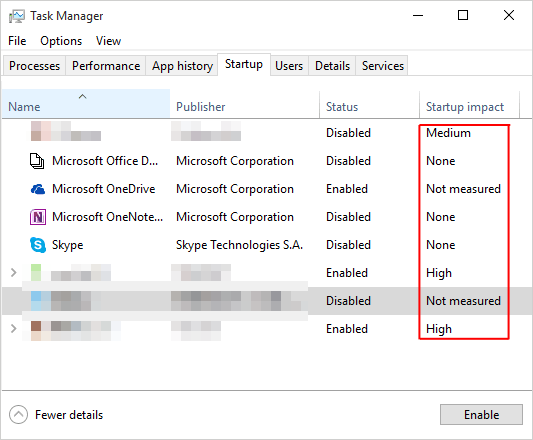

3. Manage start-up items
Solution 1: Start-up manager of Windows 10
(1) Input "Task Manager" in Cortana or right click in task bar, and choose "Task Manager", or Press "Ctrl + Shift + Esc" to trigger the Task Manager.
(2) Click "Startup" tab to turn off the unnecessary starting up as you need, or refer to Startup impact’s recommendation. (Usually, it shows "High, Medium, Low, Not measured").

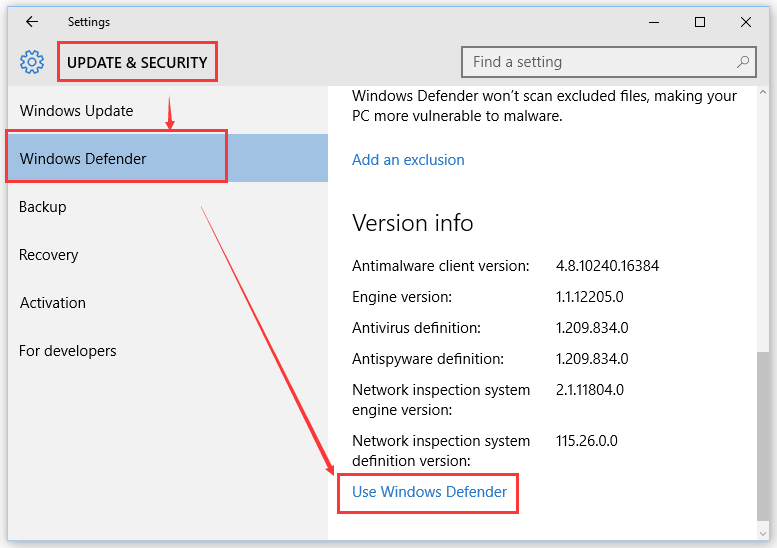

Virus and Trojan will slow down the booting and running speed of PC. It's very necessary to keep the system clean. From Windows 8, Windows system includes its own security software of Microsoft - Windows Defender. You could run Windows Defender to protect your system from virus infection.
Solution 1
Click the Notification icon in Task bar at the right-down corner of your desktop to open Action Center. Click All settings – Update & security – Windows Defender – Use Windows Defender.
